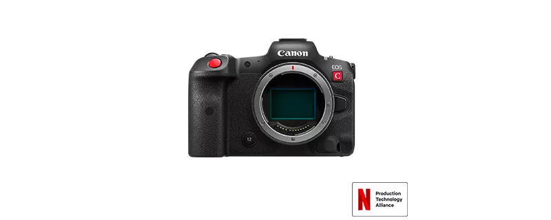

I made a battery grip for the R5C using the canon BP-A 30 batteries. Now I have 8k 60p no limitations, and battery anxiety is also nonexistent now 😂. Also getting about 2 1/2 hours of use. Thought I would share this because if I can make this you can too. Also canon can make this too. Canon or whoever please steal this idea make it better.

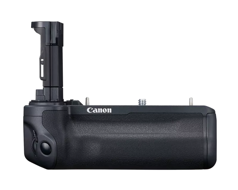

made of; NEWEER battery grip, 12v to 9v converter, canon DR-E6C converter, AND Dolgen BPA engineering battery plate.
I had to create a metal piece to connect the battery grip to the battery plate, and I had to solder it in two different places. I also use a tripod plate/shoe to add more pressure to keep it in place.
I have use this on my professional shoots to great success. I bought a second camera R5C and made a second battery grip for my two camera shoots.

This is fantastic. I guess, this could also be done with a BG-R10. If I see this right, there are no modifications to the grip itself, so buying a second battery tray (it that can be got as spare part) would give you the option of also using the battery grip like normal.
Can you show the underneath of the battery grip on how you mounted the battery plate to the grip ?

then you can add that and have lots of power options using the BPA battery. I built a special metal plate out of spare parts to attach the battery plate to the battery tray then sliding it in to fit on the back of the grip.
