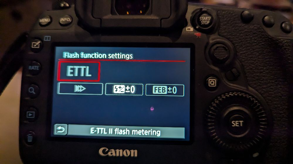

Hi @nagelxj welcome to the forums. Yes it is fully COMPATIBLE with your camera. Note the Ring Flash is NOT COMPATIBLE with the in camera flash menu. The camera can display basic settings of the flash but nothing else can be changed. EXCEPT for Flash Exposure Compensation (FEC). This can be changed as long as its not already set on the ring flash. Items in the camera menu will be grayed out or missing. Certain setting changes will need to be done directly on the flash itself. The camera menu will reflect those changes. It will be grayed out and can't be changed from the camera menu. The ring flash will NOT fire if the shutter mode is set to Fully electronic. It will fire with Electronic First Curtain or Full Mechanical shutter.

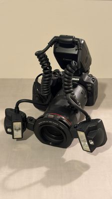

nagelxj
Thanks, I had a MT-24 for years, sold all my gear (cameras, strobes, macro gear, backdrops, etc) about 5 years ago.  but now my son is getting into it in high school.  Bought him an r6 Mii and wanted to introduce him to Macro.  I can get a MT-24 for $225 vs $1300 for a new MT26.  I loved my MT24.
Make sure you get the proper adapter rings if then lens needs it. If you look into the EF or RF 100mm F/2.8L Macro IS USM lens it requires the Macro Lite 67C adapter. The older EF L version requires it too. Also the EF 180mm F/3.5L Macro USM lens needs the Macro Lite 72C adapter. Other macro lenses have a mounting ring built in and it’s a 58mm thread. Canon has been moving to a wider mounting ring on newer lenses. But the Macro Lite was designed for those older lenses in mind. The newer L lenses didn’t exist when the Macro Lite was released. Except for the 180mm Macro.

nagelxj
Thanks all, received the flash and adapter today. Works perfectly.
