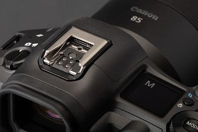

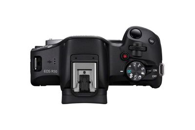

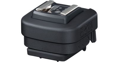

Hi @LFerrer1 the EOS R50 has a proprietary Canon hot shoe. It lacks the necessary pins to work with single pin manual flashes. Canon makes an adapter AD-E1 hot shoe adapter to work with old style flashes. Or you can just get a Canon EL-5 or EL-10 which don’t require the adapter. Other R series cameras retain the legacy 5 pins for older flashes to work.
EOS R50 Hot Shoe
EOS R5 Mark II Hot Shoe
AD-E1 Hot Shoe Adapter
