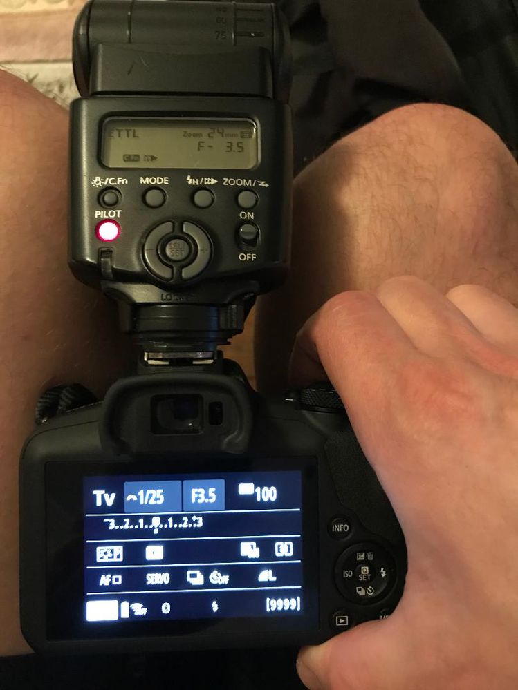

I am not sure what is metering pre-flash and when I press it don't see anything different and I don't know is the 2 flashes should be more visible.
shopstefanov89
Enthusiast
please have a look what I see on my camera:
With E-TTL and other TTL flash systems for digital cameras. They will fire a pre-flash to determine flash power. Old off the film TTL relied on light reflected off the film. So there was no pre-flash at all. If you’re only seeing one flash and the shutter speed is set to 1/30th of sec or slower. Then the flash is set to Rear/ 2nd Curtain Sync. There may be a problem with the flash. I’ll double check the manual to ensure the 2nd/ Rear Curtain Sync is available when the shutter speed is set to 1/30th sec or slower.
