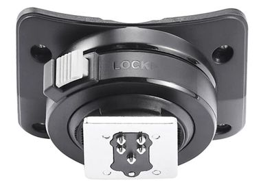

Just to confirm you have the correct flash, does the flash have 4 contact pins or 5 contact pins?
