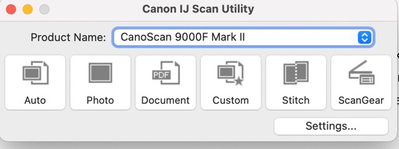

Mine still doesn't allow for use of the "Document" choice below where I can scan multiple pages.

Hi Ktalley
I installed the IJ Scan Utility (Monterey) in addition to the Lite version and it's working fine. I'm able of using all the functions.
The installed version is "My Image Garden Ver.3.6.8 (Mac)".
I didn't install the "9000F MarkII Scanner Driver Ver.19.3.0 (Mac)"
