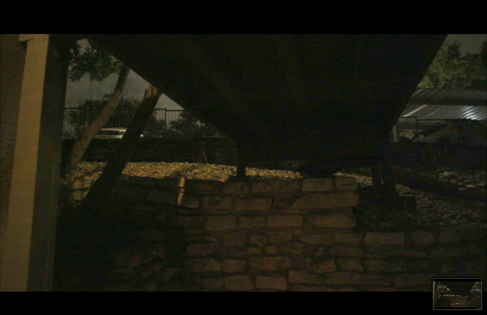

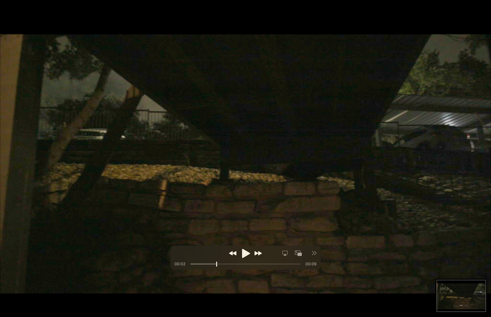

I have a c500 mark ii that creates these horizontal flares/bands. They are more visible in the shadows and in low light. I'm pretty sure it's not a flicker issue because the distortion is static and only moves around when panning or moving the camera in different directions. I thought this might be some kind light bleeding or flare caused by the lens but I tested this with my c70 in same conditions, with same lens and it doesn't have the issue at all. The only difference the cameras have would be that the c70 is a crop sensor. Anyway, if anyone can help with this, that would be amazing thanks!

Greetings zpeter,
You are correct to where the thin lines you are seeing in dark areas of the frame are not related to flickering. The cause of those lines to appear may be related to the Gain / ISO on the camera where it may be pushed too high. Due to this, the sensor's sensitivity is increased where it will brighten the image but comes at a cost of seeing noise and possible lines going across the image. We suggest lowering the Gain and using a faster lens that will work better in lower light environments, or to introduce additional light into the scene to compensate.
If the above does not apply, then you may send your EOS C500 Mark II camera to our facility for service.
