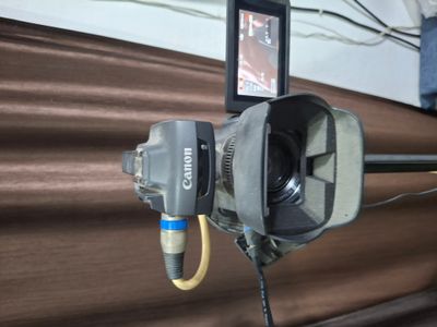

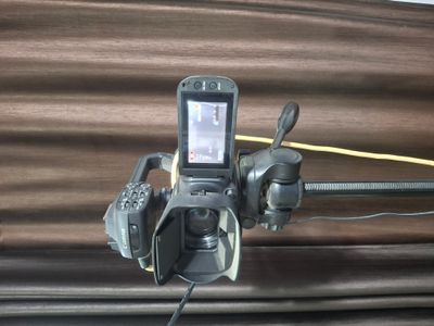

Hello, i have a problem with my canon XA11, im using it for live streaming and it shout off automatically, and start again then off. What should i do to resolve this problem.
Thanks
