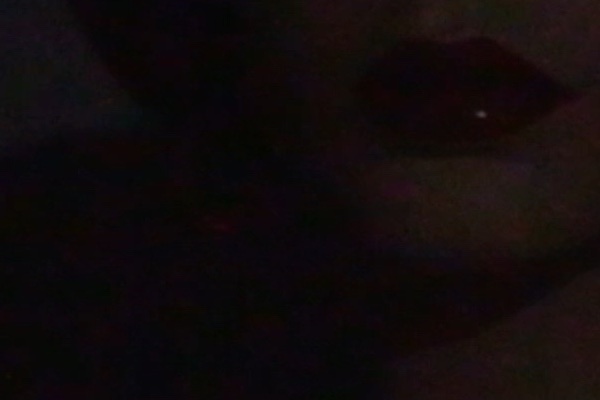

First up, my Vixia HF G50.   Since the zoom range doesn't reveal the focal length, I had to guess and approximate the framing.  I was recording in UHD with the 8-bit 4:2:0 150 Mbps codec, 23.98 fps.   f/2.8, 1/48 shutter, and gain of 24dB (at the max).  No idea what ISO this is, but I do know it would be no greater than 1600.  I'd guess this was around 1250.
Scaled down version here of a UHD frame, then a 100% view of a small section.  Along with being underexposed, massive chroma noise and artifacts in general.
