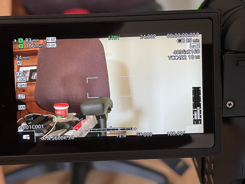

Regarding "Whole Area", I did some testing and found that as long as the defined area contains enough contrast, it will acquire focus.
Shown here are just two examples where I was using an AF Frame of "Large". When the frame was over an area with low contrast, it would hunt for focus. Whereas it would acquire focus once I introduced enough contrast.
Same for the the AF Frame of "Small".
With AF Frame of "Whole Area", since my overall scene had enough contrast, it would always acquire focus. However, it wasn't always the same item being in focus, especially if say the size of the area containing foreground elements was around the same size of the area containing background elements.
