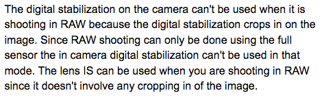

09-10-2021 12:24 PM
This is an addendum to a prior post regarding OIS, RAW recording and the C300 MK III. Below is a confirmatory response from Canon Technical Support:
Unfortunately, Canon does not offer many stabilized lenses, and my limited use of the C300's electronic stabilization suggests that it is not terribly effective.
