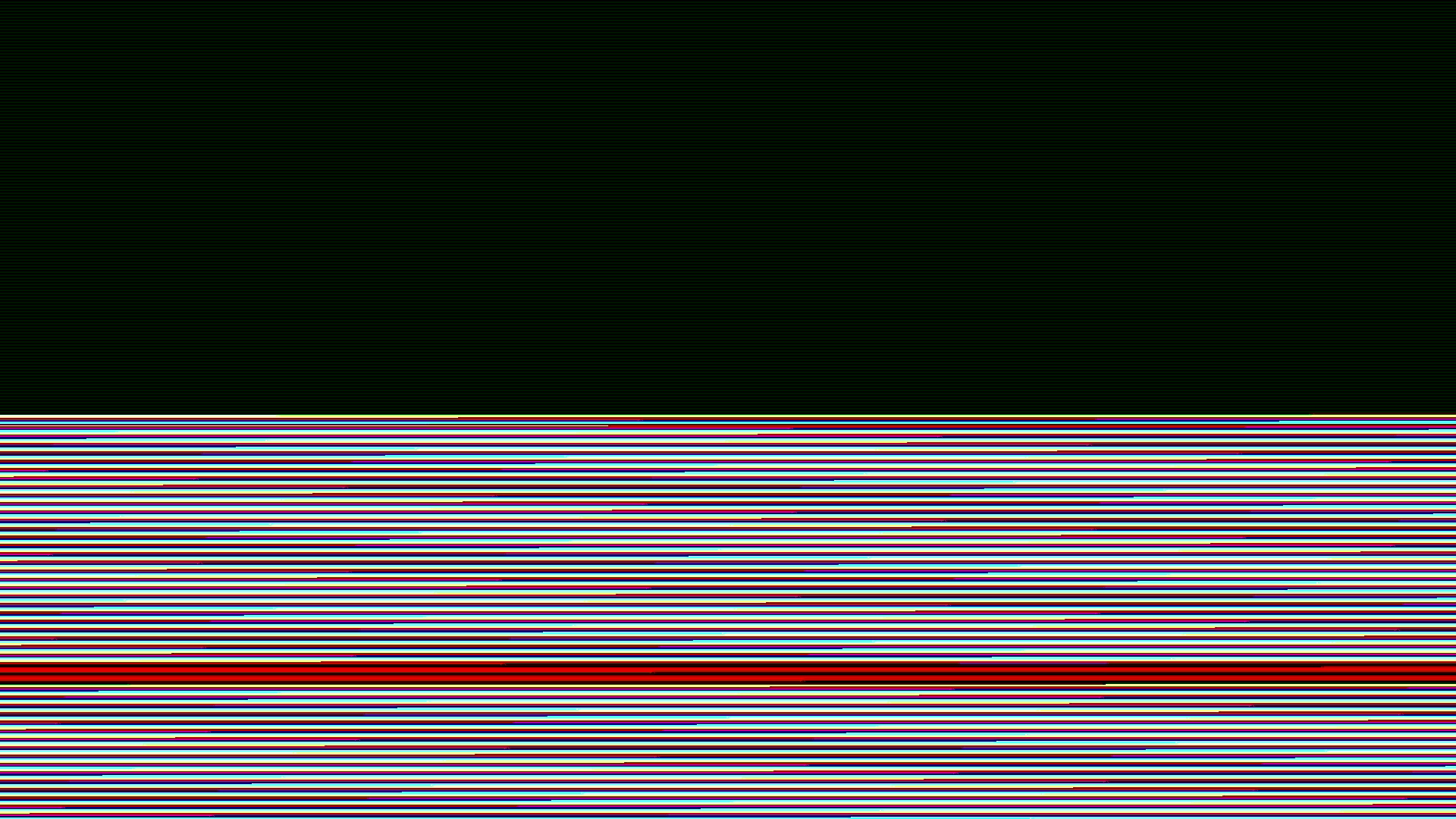

Flipped on my C100 today to test some monitors and there was no image in the viewfinder.  I tried on both AC and Battery power.  I checked the HDMI output.  I switched lenses.  When the camera is in 24p I get an image like the picture that I've attached.  (This is a frame grab from a recording I made with the camera).
I last used the camera a couple weeks ago and it was fine.  It has been in the Pelican Case securely nestled in foam.  I just flipped it on and got what you see here.  I tried flashing the Firmware to the latest, it was successful but made no difference.  When I flashed the firmware the settings reset and in 60i, instead of the image in my attachment, I got a full black screen with moving horizontal green lines.
Do the sensors just crap out like that?

Hi Spassvogel,
It's hard to say exactly what caused this, but from the looks of it your sensor is likely having some kind of issue since the menu system and other functions of the camera appear to be working without issue. I don't think there are really any at-home remedies for an issue like this so the best bet is probably to have it checked out at a repair facility.

I sent it into Canon.  $660 estimate to replace main PCB board.  I don't know if they actually pinpointed the problem or not, it sort of sounds like this is a fix-all.
