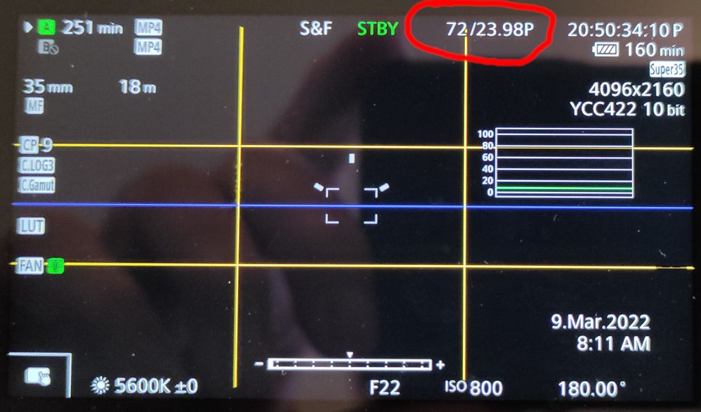

Hi,
Good news is that everything's fine. You're just not used to the complexities of Slow&Fast mode -- and I don't blame you. 😉
Slow&Fast is different to just shooting at high speed. If I shoot high speed, say 59.94 FPS, then the camera captures 59.94 frames per second, and stores them in a file; then it sets the metadata in that file to say "Frame Rate: 59.94". Then everything's easy.
In Slow&Fast mode, it's different. The camera shoots at one frame rate, but sets the meta-data in the file to a different frame rate -- in effect, the file's meta-data is lying about how fast the footage was shot.
If you set the camera to Slow&Fast mode, you'll still have the "Frame Rate" setting on page 1 of the shooting menu, but you'll see a new "Slow&Fast Frame Rate" option appear on page 2. The "Frame Rate" setting on page 1 tells the camera what to set the file's meta-data to. The "Slow&Fast Frame Rate" setting on page 2 tells the camera how fast to actually shoot.
What this boils down to is that the camera shoots at one speed -- say 120 -- but the file is tagged with a different speed -- say 60. So when you play the file, it plays at 60, because this is what the player thinks the file was shot at. But it was actually shot at 120, so you'll see it play at half speed. So it's automatically slowed down for you; which is why this mode is called Slow&Fast.
The display in the camera shows both speeds. See my attached screen shot. "Frame Rate" is set to 23.98, which is what the file will be tagged with; but "Slow&Fast Frame Rate" is set to 72, which is how fast it will actually shoot. This is displayed as "72/23.98". In your case, the screen shot shows that you set it to record 120 frames per second, but tag the file as 59.94.
Remember that the frame rate saved in the meta-data is just an advisory to the player; you can ignore it and set your own playback speed. Effectively, there's no point in setting "Frame Rate" to anything unusual, because you can ignore it and set the playback speed to anything you like when you edit. You won't want to have it play back at less than 24, though, or it will look jerky.
