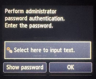

Hi Patrick, I have the exact same problem but when I try to reset all settings its still asking me for the admin password to confirm the reset. Is there any other way?

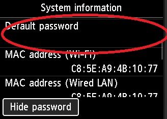

Please follow these steps:
1. Please turn your PRO-1100 on.
2. Use the down arrow to select Printer Information and then press the OK button.
3. .System Information will be selected. Press the OK button.
4. Show password is currently selected at the bottom. Press the OK button. When you do that, "Password is displayed." will appear and then will return to the System Information screen. Hide password will appear in the lower left now.
5. On the System Information screen, please use the down arrow until you see Default password.
Is there a password listed?
Or is that entry blank, as in the example below?
05-27-2025 01:33 PM
Hi Patrick,
thanks for your reply!
Yes, the default password is empty just like the picture shows.

05-27-2025 03:27 PM
Unfortunately it immediately starts to ask for the admin password as soon as I click on LAN settings
