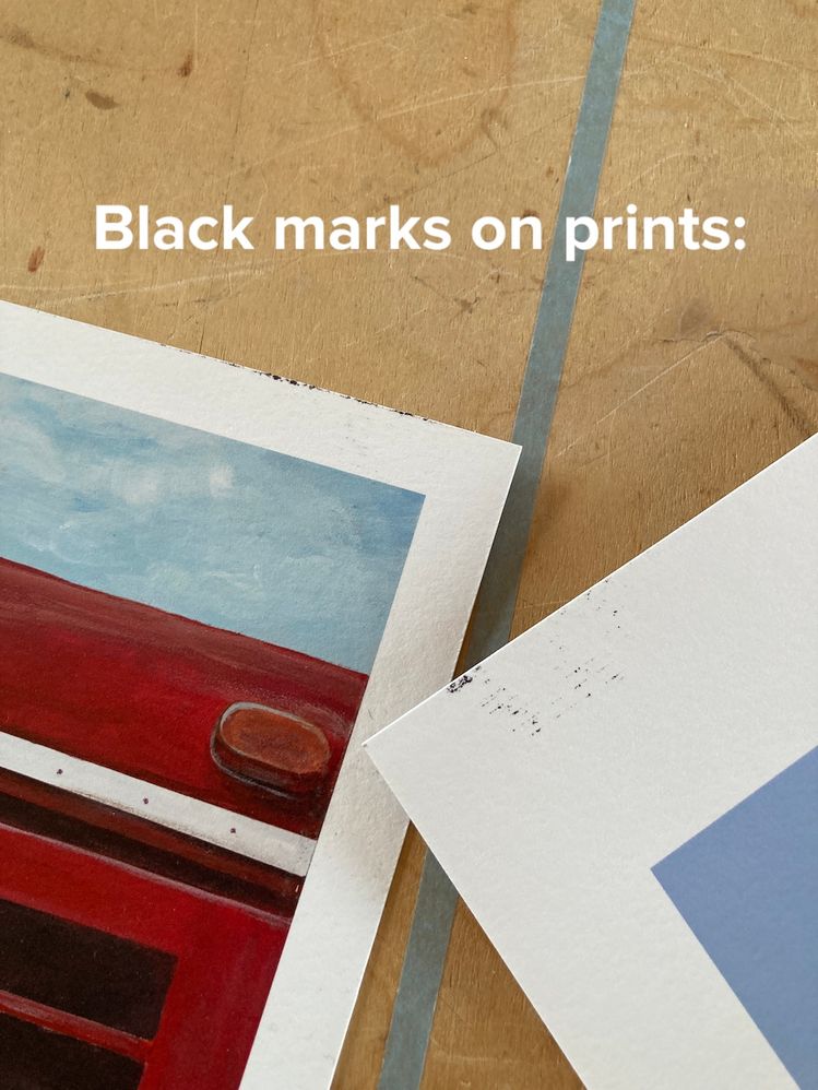

Hey guys, I've had my pro1000 for 2 years. I print almost daily to keep it printing well. I print fine artwork prints with it, have been using the same paper for years, Hahnemuhle Photo Rag Satin 310 gsm, never had a problem.

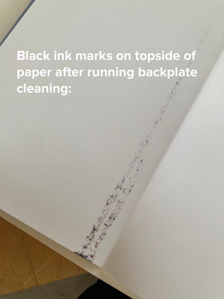

Recently I've been getting black ink strikes at the top and bottom of my prints. I have ran every single clean option on the printer. Specifically I noticed when I ran the bottom plate clean, I consistently get the same ink smudges on the face of the paper. I've ran the bottom plate cleaner over 20 times now and still no improvement.

I make sure my paper is good and flat before feeding it into the printer, but no matter how flat it is, still I get these strike marks. I have not changed the paper or settings since this started happening.
