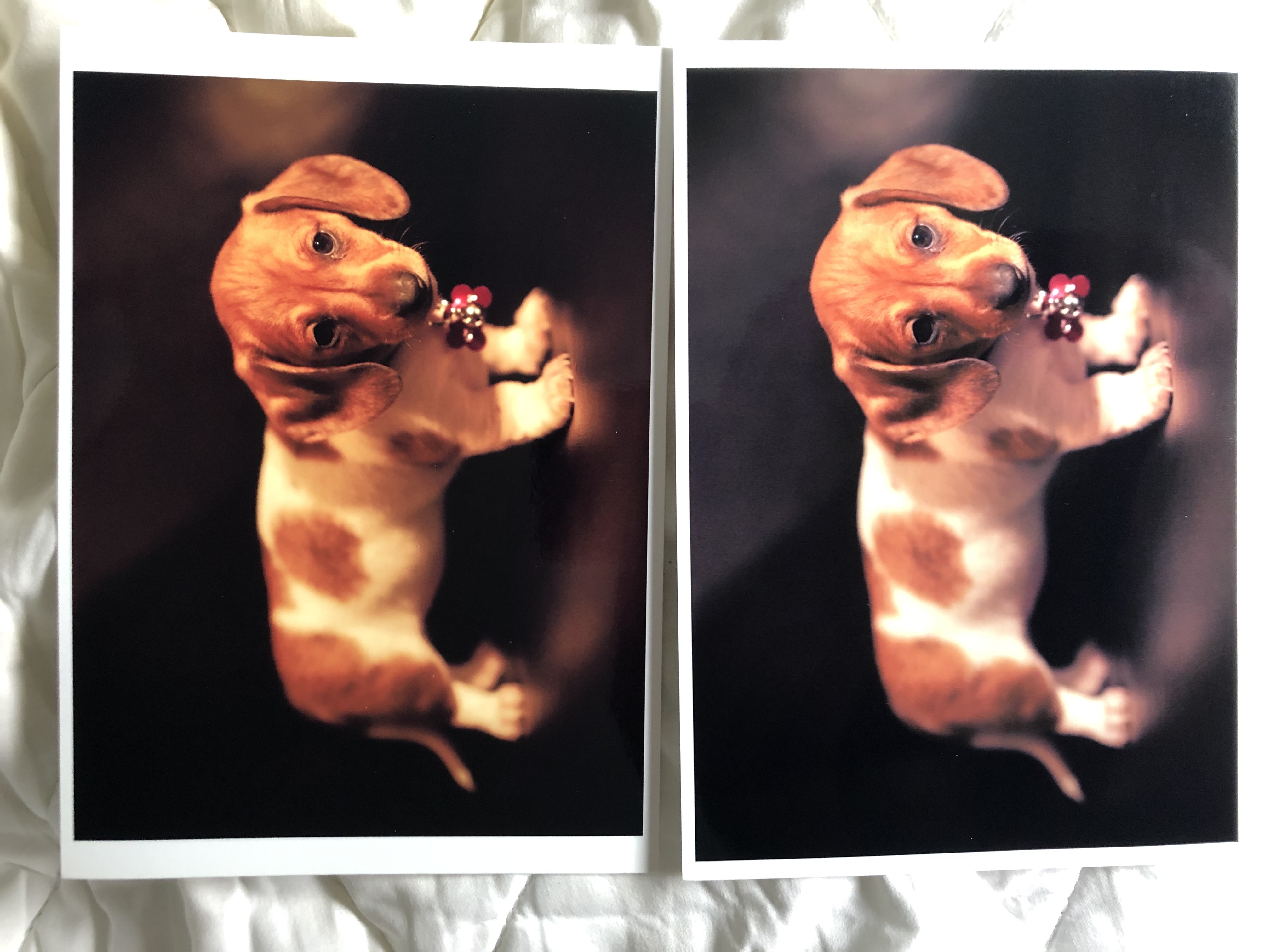

Here's a phone snap of color difference printing from my phone to the pro 100 and the ts8300
the pro100 is slightly sharper, better quality print but it's coming out too warm. The ts8300 has nicer more accurate color for a much lower price straight from an air print iPhone using the same canon print app.
suggestions? How do I fix the color on the pro 100?
12-24-2019 01:09 PM
Hello.
The results between the two different printer models will not be identical. Some adjustments may need to be done to match the output.
First, make sure that the appropriate media type is being selected before you print. If the wrong media type option is chosen, this can cause issues with color output.
If the issue persists, try using the Print Studio Pro plugin. This has a "Pattern Print" feature which may be helpful with matching the output. Details about the plugin can be found at the this link.
