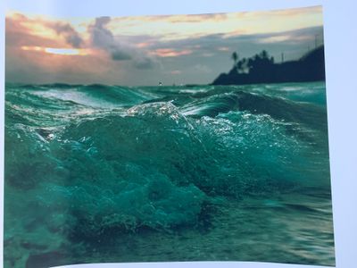

I tried it on my Pro 4000, too, and it's just as murky, and very green looking. Here is the digital version.
12-08-2019 02:07 PM
Here is the printed one and somehow the camera shot of it makes it look a lot brighter than it is in person.
12-09-2019 10:23 AM - edited 12-09-2019 10:25 AM
The greenish cast appears to be the absence of Magenta ink. Yet, you have this on two devices. So, what about the ICC profile you are using and is the correct paper type selected?
What happens when you print a nozzle check pattern? Is everything normal?
Great picture of the water BTW!
12-09-2019 10:15 PM
Thank you!
Interesting on the lack of magenta. I wouldn't have considered that. I made a new custom paper and embedded the paper profile, then turned off the color management. Seems to have gotten rid of the green tinge. Did a print nozzle check and that is coming out ok. Murkiness is still there but I'm wondering if maybe this photo's color range is just not translateable to paper?
