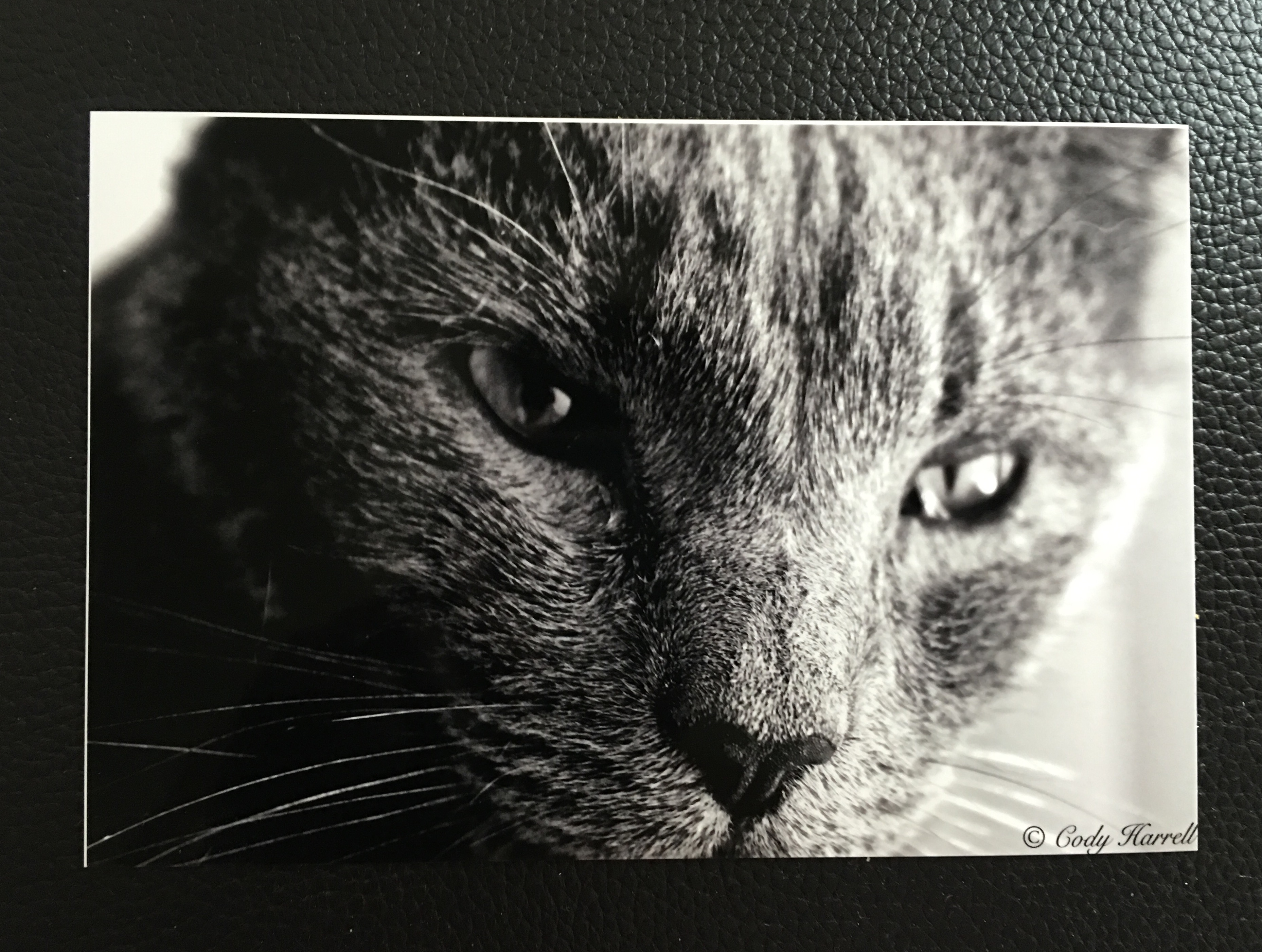

Hello, I'm new here, so sorry if this has been posted else where, but I couldn't find it.
I just got a Pixma Pro-100. LOVE IT! However, when I print, the photos always have a border if I choose None on "Amount of extension for borderless printing. I want the ENTIRE photo printed, not a slightly cropped one, which is what happens is you choose small, medium or large. So I choose my 4x6 with None for that option, it prints EVER so slightly down and to the right. In print settings I have set: Printer: Pro-100, Media Type: Other Glossy Paper (I use Epson 4x6) and for paper size I choose: 4x6.
Any ideas would be greatly appreciated.

I think you are dealing with the fact that there are manufacturing tolerances to deal with.
You select None and the printer does its best to get the entire image on the paper, but its not perfect.
Select one of the extension options and the printer makes the image slightly larger, but you loose some becasue it overprints the paper.
I've never found a way aroiund this on my Pro-100. I use a quality paper trimer and just cut off the tiny white area.
As an aside, you don't want to do a lot of borderless printing because you wind up spraying ink inside the printer and it can wind up getting on prints if it gets a lot of it.
01-07-2016 03:35 AM
Well dang. I'll just have to keep playing around with it. I know you can do it. I mean, that's one of the reasons you have to choose the paper size, so the printer knows where and how big to print right?

That's what I said in my original post. I have those options, however, when I select None and the borderless, I still have that small margin.

If I DO select an option, like small, medium, etc... the photo is then enlarged and cuts off parts of the photo. Hopefully this can be fixed with an update.
