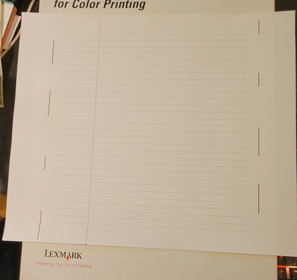

My Pro-200 has recently started printing lines down each side of the page if I am printing something larger then 8.5 x 11. The lines are about 9.75 inches apart.
I used on the the built in templates from the printer, so it does not appear to be a driver issue.
Any thoughts? Thank you
10-21-2025 01:54 PM
Hi TheDoctor,
To resolve this issue, please perform a bottom plate cleaning following all of the steps provided on this page:
PRO-200 > Maintenance > Cleaning the Printer > Cleaning Inside the Printer (Bottom Plate Cleaning)
Please make sure to clean the inside using a cotton swab as described at the bottom of that page.
