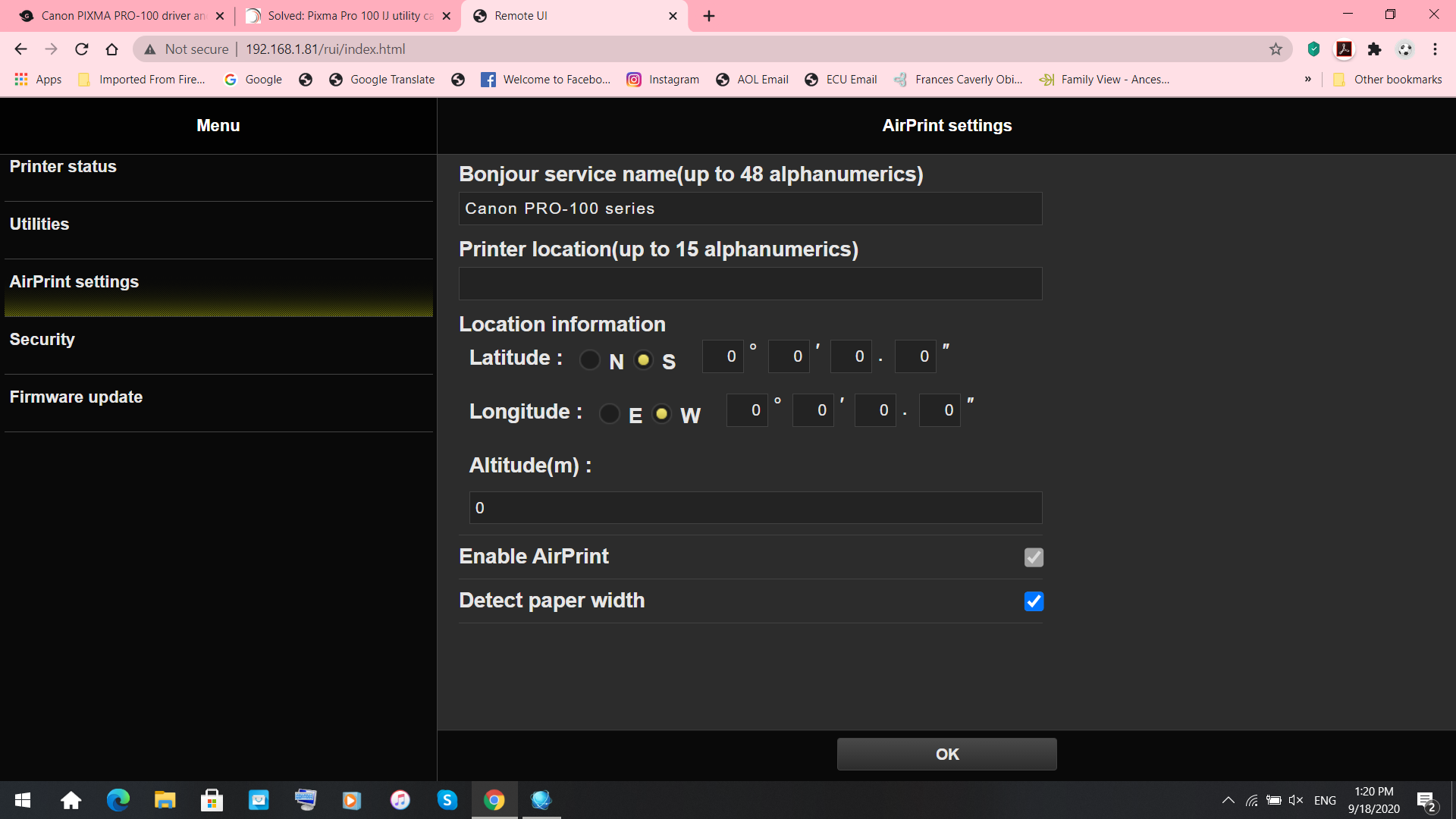

My Canon Pro 100 can be found on my network but it says it cannot find the driver. I downloaded the driver from the canon website but still nothing. I have been trying to get this thing to work so I can start using it.
I am attaching a screenshot of what the webpage looks like but I cannot figure out how to fix this. Its brand new and my OS is Windows 10. When I click on Utilities, it just shows Language and Confirm LAN settings. HELP PLEASE!!!

Welcome to the forum lioness65.
It looks like you are trying to set the printer up as a Bonjour printer. That is a very limited printer configuration.
I suggest you follow the instructions in the guide:
https://downloads.canon.com/wireless/PRO-100_setup.pdf
If you need additional help come back.

Here is what I would try.
1. Go to Control Panel->Devices & Prinbters and right-click-remove the Canon Pro-100.
Go into Control Panel->Programs & Features and uninstall programs associated with tyhe printer.
Go to the Canon support site and download the latest driver:
Download the second, not the XPS driver.
After you install the driver go to the instructions I linked and see if that works for you.
