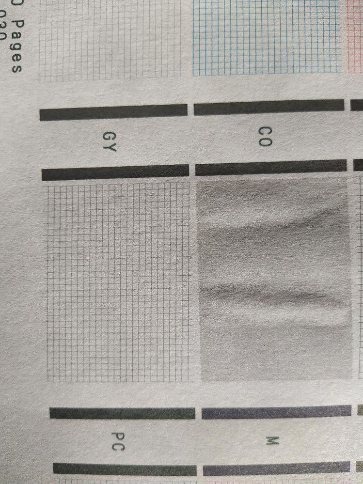

And this is my Grey nozzle check after the cleaning of purge pad:
