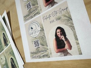

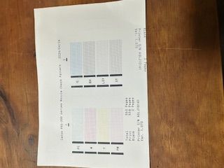

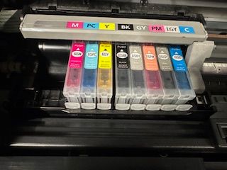

My printer has started printing everytihg with a heavy green hue. When I run a print test or color block test it prints beautifully. I have printed several different files and files types and media types and they all come out with a green hue. We have even sent the files from various programs and computers with no change. All my inks are full and in the right slots. We checked and we don't have any clogged nozzels and we are current on firmwear updates. What could be causing this? How can I fix it?

You say the nozzle check prints OK.
What print test and color block test images are you using? Are they the same image type as your own -i.e. JPEG or TIFF?
Are you printing your test images using the same settings and media type as your own images?
Can you post a screen shot of a problem image?

We printed straight from Adobe illustrator and Photoshop and a jpeg from off a random file on my computer. The Color Block, test print are directly from the actual printer.
04-25-2024 02:39 PM
the images are supposed to be light beige

I have the EXACT same problem with my printer. Happend sometime after I changed the printhead. Tried aligning it several times and all new ink etc. Pattern prints just fine but photos all have a green tint that´s getting worse and worse. Im at a loss aswell so hopefully someone will write a solution here.
