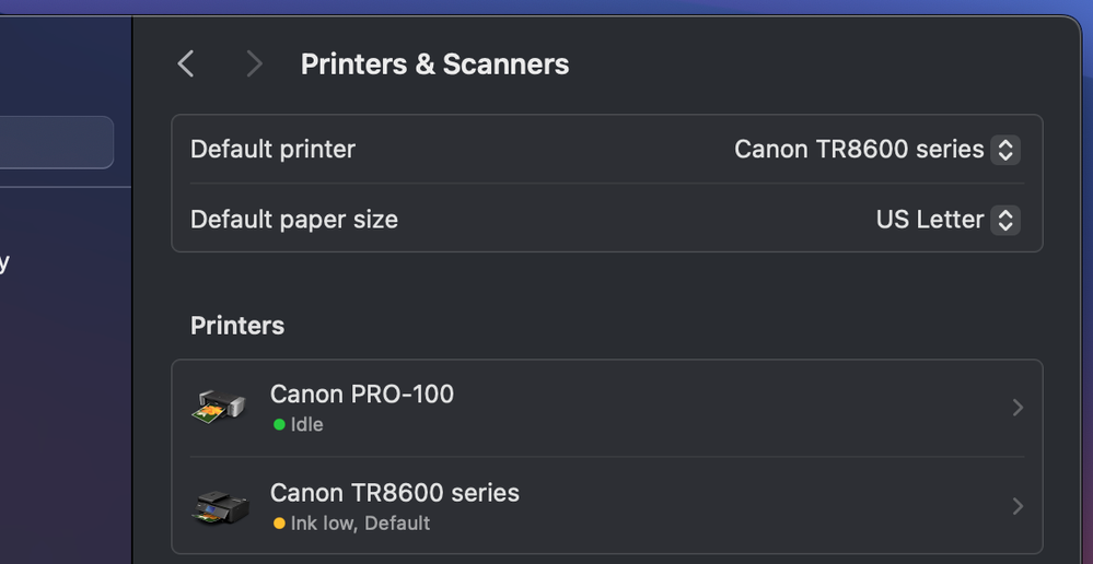

Go to Printers & Scanners and select the right arrow for the Pro-100. That will show you the driver that is installed.
Screenshot 2023-12-19 at 7.34.12 PM.pngScreenshot 2023-12-19 at 7.34.41 PM.png
If you don't have the Canon driver select add printer and wait. Could take several minutes for the Canon driver to appear.

cmpentecost
This is what shows on mine:
