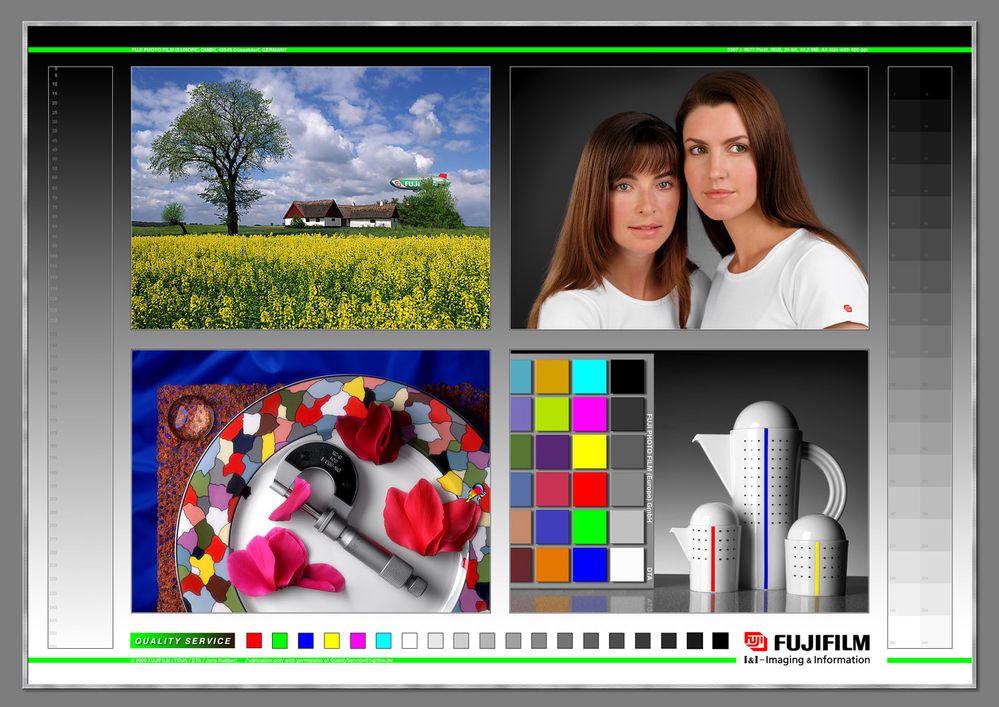

I have been printing on a Canon PRO-100S on Canon paper from LR Classic with excellent results... until "something" happened, possibly to the drivers but perhaps to the printer. see attachments below: standard Fuji test image and a snapshot of the best test print of it I could produce (you will have to trust that the shot reflects the actual printed colours).
I have been following the thread and tried resetting the entire print system. Sadly no improvements.
Setup:
Canon PRO-100S with 16.80.0.0 MacOS driver
Mac OS 14.2.1 (Sonoma)
Lighroom Classic 13.2. (but same results using Canon apps like Image Garden etc)
Any other ideas please??
For context: I routinely print from LightRoom Classic. The entire printing workflow is fine-tuned, incl softproofing using the correct paper-specific Canon colour profiles for the printer and the paper I use (eg Canon Pro Luster), setting colour management in LR to the same colour profiles , matching printer setup to the LR printing setup: colour matching correctly disables (as it's handled by LR), media type correctly set for the target paper, etc. nothing has changed, but the results are now very different -- and frustrating.
thanks! -- Paolo (UK)
photo of printed test image:
printed (& photographed)
original test image:
original

Please run a nozzle check to be sure all colors are printing correctly.
04-22-2024 07:31 AM
deep cleaning seems to have done the trick!
very grateful, thank you 🙂
