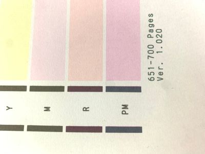

07-30-2024 10:53 AM
just printed it. Looks fine to me, although there is a slight magenta shade on the right side of the PM cartridge mark. Could just be head mis-alignment. Everything else seems normal.
would this mean the issue likely lies with software?
thanks for the help,
Val
07-30-2024 11:04 AM
Check your M and PM cartridges. According to Canon M should be darker than PM.
07-30-2024 11:40 AM
It is a bit lighter bust still doesn’t look as light as it should be. I would say it’s the same intensity as the Magenta ?
07-30-2024 11:43 AM
Sorry, I forgot to add that I have changed the PM cartridge with a new one.
07-30-2024 11:44 AM
Are you using Canon inks? My Pro-100 shows a similar pattern of PM lighter than M. The purpose of the “P” inks is to give a greater range of color.
07-30-2024 11:50 AM
No, not using canon inks as they are too expensive. It’s a German manufacturer and I’ve printed before with them without this issue. Do you think it could be an ink problem? Is there a way I can do an overall clean and start from scratch?
thank you, Val
07-30-2024 11:54 AM
Was there an ink cartridge change between when you were getting good prints and problem prints? Maybe contact the ink supplier. Perhaps a quality problem.
07-30-2024 12:23 PM
Will do, I’ve done more tests and it persists. Is there any way I can do a full nozzle clean and start fresh? Do you have any recommendations for decent inks that won’t break the bank ?
thanks for the help
07-30-2024 12:41 PM
I don’t have any direct experience, I use Canon ink, but many folks report good experience with Precision Color inks.
A friend installed P and PC backwards in his Pro-100 and two cleaning cycles straightened him out.
07-30-2024 12:51 PM
I’ve done four more full cleans in the meantime and it seems to be getting better.
There are still a few images where a can see a slight cast but I will run more cleaning cycles
If this slight cast still persists I will try the cyan swap you suggested, but the worst is definitely fixed.
I was sure it was double profiling but it looks like that was it!
Thanks so much for the help John, truly a Legend!
Val
