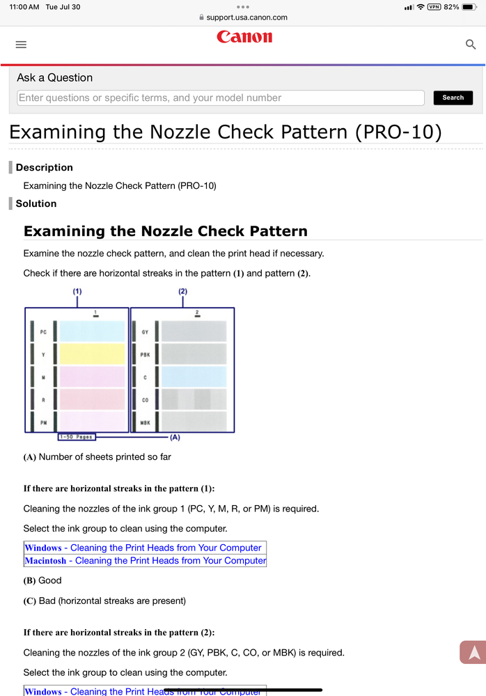

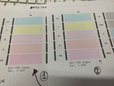

just printed it. Looks fine to me, although there is a slight magenta shade on the right side of the PM cartridge mark. Could just be head mis-alignment. Everything else seems normal.

07-30-2024 11:04 AM
Check your M and PM cartridges. According to Canon M should be darker than PM.

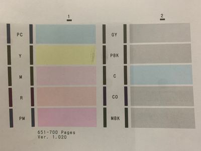

07-30-2024 11:40 AM
It is a bit lighter bust still doesn’t look as light as it should be. I would say it’s the same intensity as the Magenta ?
07-30-2024 11:43 AM
Sorry, I forgot to add that I have changed the PM cartridge with a new one.
07-30-2024 11:44 AM
Are you using Canon inks? My Pro-100 shows a similar pattern of PM lighter than M. The purpose of the “P” inks is to give a greater range of color.

A friend installed P and PC backwards in his Pro-100 and two cleaning cycles straightened him out.
07-30-2024 12:51 PM
I’ve done four more full cleans in the meantime and it seems to be getting better.
There are still a few images where a can see a slight cast but I will run more cleaning cycles
If this slight cast still persists I will try the cyan swap you suggested, but the worst is definitely fixed.
I was sure it was double profiling but it looks like that was it!
