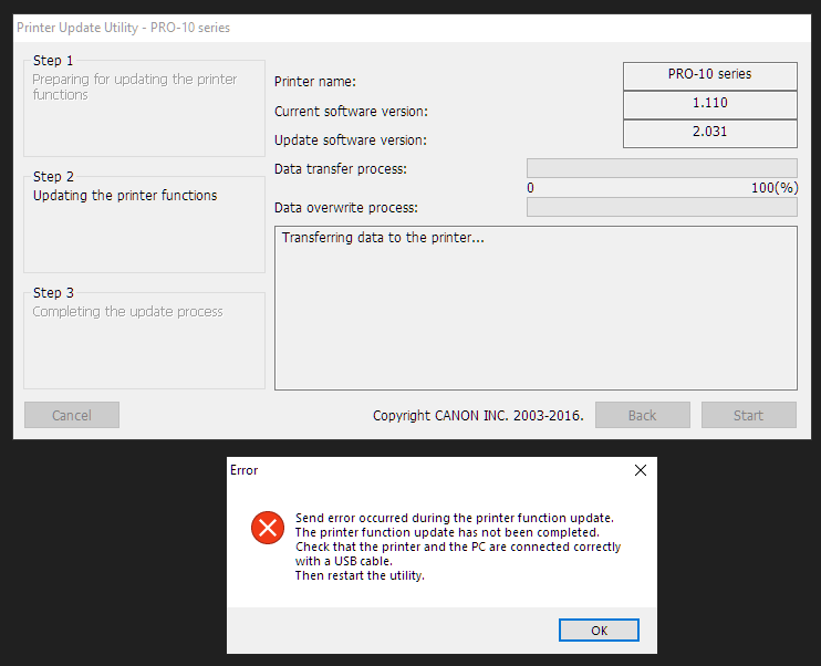

Im unable to update firmware on my PRO-10 printer.
1.110 firmware are installed. Downloaded latest firmware from canon support site.
Tried with different USB-cables, different computers both PC and Mac.
When i press Start in the update program printers power status led starts blinking white.
After a while update status says transefering.. and then i got a blinking orange status led on the resume button. That flashes three times and then loops. Update program then throws an error.
Please do somebody know whats wrong?
Canon support couldnt help me when i contacted them via a filled in form.
I will attach a screenshot of the update program and the error.

12-10-2021 09:31 AM
No solution required (other than perhaps some clarification in the download description). This is a known occurrence. Many posts on this forum and DPReview.
Explanation seems to be that 1. there are two versions of the circuit boards in the Pro-100 and Pro-10 printers. 2. the firmware update applies to the later versions of the printer which came with FW 2.0. 3. the 1.x FW for the Pro-100 and the Pro-10 is the latest.
