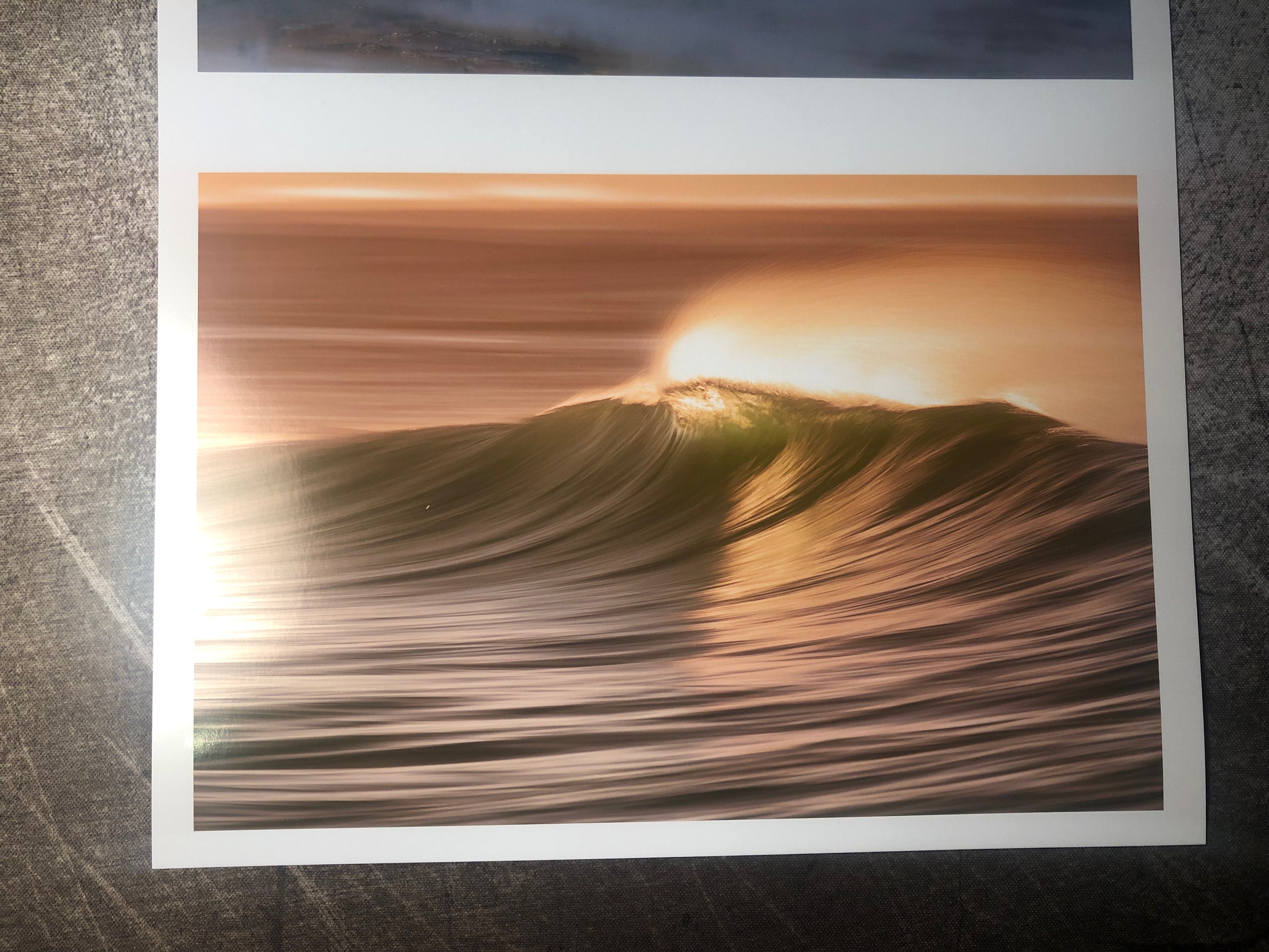

I have just used the Softproof function, and adjusted the image to below Softproof. This was then printed, but the result is a mismatch. The print turned red and looks much worse than then the bottom image below. What was meant to reduce the yellow-orange turned into pink-brown print. I think below is not a true reflection, as the very bottom is a photograph of the print. The disceprepancy between these two is worse than what is shown here.
