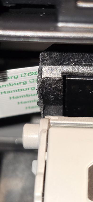

Hello,
Hoping I can get some help on this. I recently bought a used Canon Pro-300 printer. When I went to set it up, these two parts were laying on the bottom of the printer floor. Needless to say, I received a error message upon setup. The parts don't look broken. Looks like something that came loose during transit. Would anyone know where they belong and how I might be able to put them back in place?
Thanks in advance
-Manny

cybn
Hi, I have the exact same issue with my Pro 300. The parts were loose on the 'back shelf' top left corner when looking at the printer innards from the front. The parts work together somehow. I got error C000 initially, then error 5100. I did not even notice these parts for a few hours troubleshooting. I carefully removed the two parts with a tweezer afterwards. They look like some kind of carriage control / offset markers possibly. This will be a mystery to the previous owner too I imagine. It WAS working for them.
After removing the pieces I got error C600.
Canon UK say that the printer needs repairing.
Maybe so, but why are these parts loose? Where do they fit, if anywhere?
What are they for?
Could Canon tell us what is happening in this case?

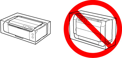

For anyone moving a PRO-300, you have to strictly follow Canon's guidelines to prevent this:
  1. Use Transport Mode: Never just unplug the printer. Use the printer's menu to initiate its official "Transport Mode" (which caps the printhead and locks internal gears). Wait for the power light to go completely dark before pulling the plug.
  2. Immobilize the Carriage: Manually slide the carriage to its home position and secure it tightly with residue-free tape (like painter's tape) so it cannot slide during transit.
  3. Keep it Perfectly Flat: According to the official Canon imagePROGRAF PRO-300 Manual, you must never tilt the box, turn it on its side, or flip it upside down. Standard shipping couriers (UPS/FedEx) rough-handle boxes, which is why this failure is so common on secondary market sales. It should ideally be transported flat in a personal vehicle.
