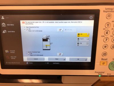

Hello,
I have a Canon ImageRunner Advance C5535i in my office. Literally every time anyone sends a print job to the printer, we get an error that "The appropriate paper size, LTR, is not available. Select another paper size, then press [OK] to start printing. We have 2 trays full of standard 8.5"x11" letter paper. We have to press OK for every single job. Anyone have a solution to this problem? It is very frustrating.

06-05-2020 09:43 AM
hey yanman
Have you tried to fix pager size in printer property section and applied this setting as default ?. It may resolve your problem permanently.

06-01-2023 04:34 PM - edited 06-01-2023 04:40 PM
I had and solved this issue by doing the following on the touch screen of your printer
Note: I did not have much time to make this solution fool proof. Just use this reply as a guide to solve the issue on your own.
