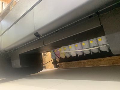

Hello, the issue is with the grommet / valve on the underside of the sub ink tanks, gets weakened after the many cycles of use, causes a tiny hole which air gets in and allows ink to leak out, air goes into the cartridges so their not vacuum sealed which is why when you put a new cartridge in it empties in days “if your lucky” it’s a part that should cost pennies to fix I’ll attach pics of the culprit, either buy a wrecked machine and strip for grommets, or my solution I built an automatic ciss bulk ink system bypassing the factory sub ink system

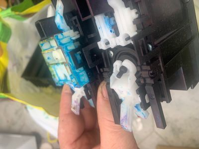

I would be very interested in what parts you have chosen to have a alternative ink system. I just took a pro 4000 apart and I have the same issue like in the very good YouTube „Canon imagePROGRAF PRO-4000 Ink Leak Hunt“ video. But I also found the reason why it’s breaking. No part is rubbing and also it’s not because of bad assembly but it’s by design. Now I’m in between writing to Canon and sending them details about how it broke. And to ask for a replacement. Or maybe I also try to glue it. But most likely it won’t last forever. Or to find a alternative solution for the ink supply like you did. But I would need more information on how that is archivable.
This one is close to braking. Everywhere are rubber particles.
here you can see the underside from the broken one. It’s obvious that the motion of the rubber is always going to cause a leak.
Did anyone try to get it fixed by Canon? I think it should be fixed because of goodwill. I did see a pro 4000 for sale and the guy send me the cost estimate from a canon technician. He wrote that canon is claiming this only happens because of old ink. But in my printer was never expired ink and also always original canon ink and as you can see it is obviously happening by design:
