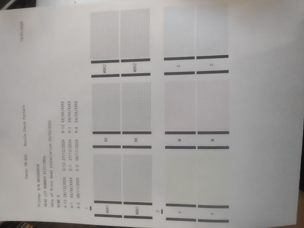

Thank you for taking a look. I use Tecco 230gsm matte coated paper, which is a high-quality paper, and I indeed use OEM inks, with which I've never had any problems. Just a few days ago, I got the same model (used one) that was serviced and works well, but the problem with the first printer still persists.
One thought came to mind: could I have accidentally put photo ink into the MBK slot if they were mislabeled? Or could it be an issue with the printer head? However, I just performed a nozzle check, and it looks fine to me. Pictures attached. Thanks!IMG_20250113_153438169.jpgIMG_20250113_153438169.jpgIMG_20250113_153049817.jpgIMG_20250113_153049817.jpg

Your nozzle check does indeed look correct. The question about wrong ink is hard to do as the cartridges are keyed. Could you attach a picture of the MBK cartridge and label?
