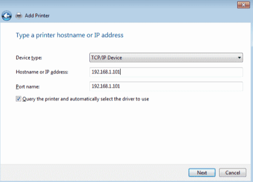

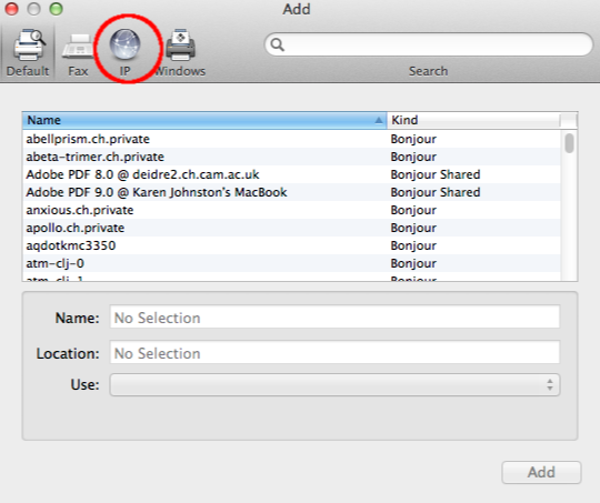

Greetings,
This should be easy to fix. Reserve an IP for your printer by its MAC address. Give it an IP that doesn't change.
This can be done on your router, only requiring a restart of the printer for it to "pick up" its new IP. Now your printer has a known "destination" IP that never changes.
Now remove and reinstall the printer from the existing devices it is installed on now. Restart each. Then reinstall on each using the printer's IP.

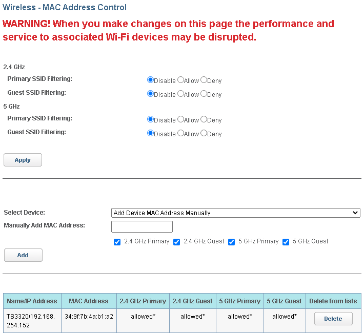

10-15-2020 11:20 AM
Good morning,
The below screenshot courtesy of my router's webserver shows a permanent (until hardware reset) setting but since it says very little, I didn't know "This is what tells the router the device with MAC xxx gets IP xxx. It won't assign it to another device regardless of when the device is used or seen on the network again".
I believe this problem is solved.
