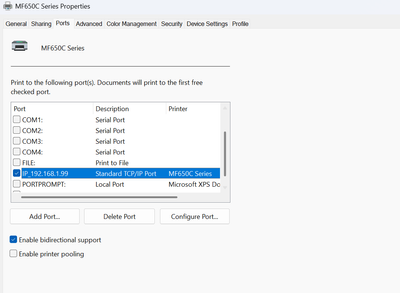

I would also recommend that you install the printer as a TCP/IP device. This identifies the device to your operating system (Windows or Mac) at its destination IP. It will use that "destination IP" for communication. See the example below (windows). I have this printer installed as a TCP/IP printer. This is the same IP address assigned to it on my router. This can be done on MAC OS as well.
