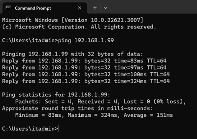

Do this from a web browser or command prompt. Example, my printer is assigned IP 192.168.1.99.
Web Browser:
Command Prompt:

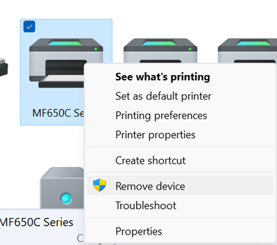

On one of the systems, navigate to Start menu > Settings > Control Panel > Device and Printers
Find all instances of the TR7520. Right-click and select remove device.

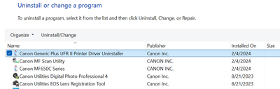

Now return to Control Panel and open Programs and Features. Uninstall all drivers for the TR7520
