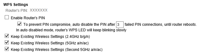

Most (if not all) Netgear routers do not allow you to input a WPS PIN from your device.
The following is an example.  Nighthawk R8000P.  I've put XXX"s where my PIN displays.
Note, this applies to at least 14 of Netgears current routers.  (Users don't get to specify their WPS PIN)
Here is the Netgear KB article for reference
Linksys Routers do allow a devices WPS PIN to be entered.
Your ability to perform the steps in the referenced Canon article will depend on the router you own.  If not supported, you will need to assistance getting the MX922 properly reset so you can in fact enter a password (pass-phrase) to get the device connected.
