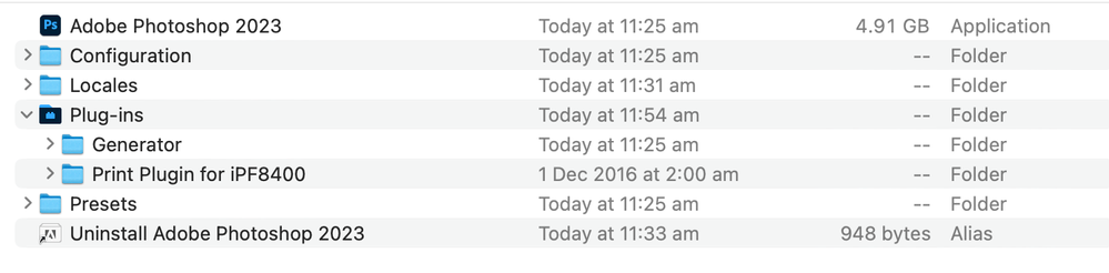

Hi Danny,
the latest description for the ipf8400 photoshop plugin states that it is compatible with OS13 Ventura and Photoshop 2023. I have tried multiple times to install it into the plugins folder but it doesn't show up when I try to export from Photoshop. See attached screenshots. Could you please help me to resolve this problemScreenshot 2023-05-31 at 12.17.23 pm.pngScreenshot 2023-05-31 at 12.02.36 pm.pngScreenshot 2023-05-31 at 12.03.20 pm.png
Hi Rhesse,
I had the same problem and after spending many hours trouble-shooting, finally tracked it down to not being compatible with the M1 chip. After setting Photoshop 2023 to open using Rosetta 2 (which is a workaround), the 'Export to ipf8400 Print Plug-in' option was enabled!! To enable using Rosetta, Control + Click the App name (Photoshop 2023), click Get Info, and there is a checkbox to open using Rosetta. I'll include a screenshot. Hopefully this works for you and anyone else that may be having this issue.

That worked. Thank you so much. Finally someone with a working solution.
Wonderful, I’m glad that my hours of research helped someone else too!
