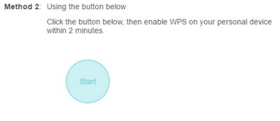

05-18-2022 12:16 PM
Hi simon_s,
Please make sure that WPS is enabled on your router:
1. Visit http://tplinkwifi.net, and log in with your TP-Link ID or the password you set for
the router.
2. Click on Advanced.
3. Click on Wireless.
4. Click on WPS.
Make sure that the WPS is active as in the image below.
Scroll down the page, you will see this:
Please follow the steps I provided previously, but this time, click the blue circle with "Start" instead of pressing the physical WPS button on your router.
05-19-2022 09:23 PM
Using that Method 2 as described did work this time. Thanks for your assistance.
