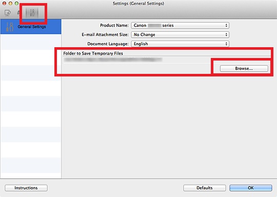

3. Open the IJ Scan Utility.
4. Click the Settings button in the lower right corner.
5. Click on the wrench and screwdriver tab at the top
6. Click Browse next to "Folder to Save Temporary Files".
7. In the Browse window, please browse to the new Scans folder on your desktop.
8. Click OK and then OK again.

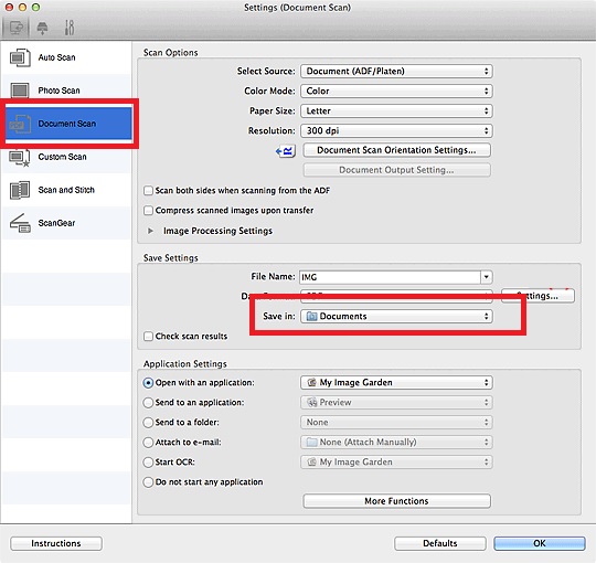

If the issue persists, try this:
1. Click the Settings button on the IJ Scan Utility again.
2. Click on Document Scan on the left side.
3. In the middle on the right side, click the "Save In" drop down box and browse to the new Scans folder that you created before on your desktop.
4. Click OK and then OK again.
5. Attempt to scan using the Document button on the IJ Scan Utility again.
