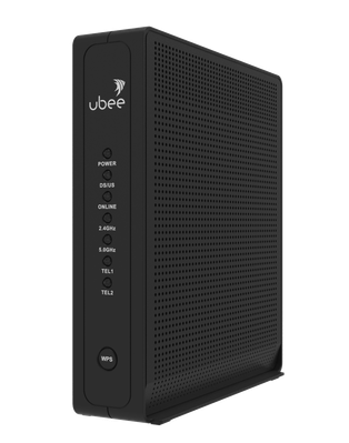

Model Name: UBC1322

I called Canon again my issue did not get resolved they are saying I have to contact optimum for a static ip address but agent said they don’t have that option, only for businesses. They said i can also have this printer connected to this modem/router via MAC address instead of ip but I cannot find a way to do it because Optimum said they can’t do it with my modem (gateway 5) router/modem. Once again the problem that I’m having is the router is not routing the printer to my computer correctly, after shutting power off it now loses the communication with the network, but it remains connected to the wifi though. My Mac says the printer is offline but it is not offline it is powered on and connected to same network that Mac computer is connected to.
