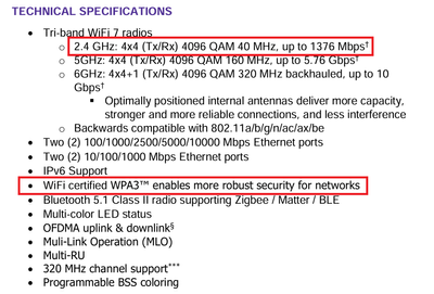

Thank you for the reply. The issue still exists. Spoke to 5 different reps including a manager and they all state the Modem (C5500XK) and the WiFi 7 Pod (W1700K) installed in my home have no issues connecting to 2.4 or 5 ghz frequency. He is right, I do have a TV from 2019, security Cameras from 2018, and a portable game device from 2024 that all connect via 2.4 ghz frequencies and they all connect just fine, the only one not connecting is the canon printer.
I went to the advanced menus for the modem and there are no settings for WPA2 or Wifi 3. I also asked the manager about this and he said that because there is no need to configure these WPA2 settings and the like, that there is no need to have these options and therefore they are not present on their end or on my end, I will upload image of the settings that I have once I go into the advance modem settings.
Very frustrating to say the least, not sure what else I can do.QF Adv settings.jpg
01-02-2025 03:59 AM
I'll leave here the link to the documentation of the W1700K wired gateway pod specs that is installed in my home for reference: https://www.quantumfiber.com/content/dam/quantumfiber/equipment/downloads/W1700K_DataSheet_QF_011924...

Greetings,
I believe you need to use the Quantum App in order to access the wireless configuration of the W1700k.
