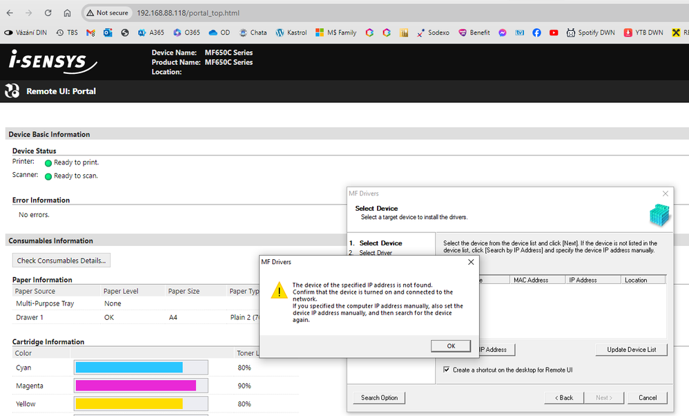

I am having trouble with network discovery while installing the i-SENSYS MF655Cdw software. The software never finds the printer, not even by its IP address.
On my PC, I tried restarting the Print Spooler and Windows Image Acquisition (WIA) services, turning off the firewall and antivirus, the printer can be pinged, it is on the same subnet, I can access the printer's web interface, I have enabled [SMB 1.0/CIFS File Sharing Support], and other PCs on the same network and even on the same Ethernet cable can find the printer without any issues.
On both devices is DHCP autocinfiguration enabled.
On the printer, IPv4 is enabled, [Multicast Discovery Settings] has been enabled.
I am already desperate. Does anyone have any idea what could be wrong?
Thanks a lot
Marek

The LAN has one Fortigate 60D router where the DHCP server is located. In the network, there is a Cisco POE switch without any VLANs or other functions set up. The printer has a reserved IP address in the DHCP server. The PC's operating system is a newly installed and up-to-date Windows 10 Pro.
I am installing the MF650CMFDriverV720W64.exe package. However, neither does GPlus_PCL6_Driver_V300_32_64_00.exe work.
The only option is to manually install the drivers into the OS and then add the printer by IP in the Control Panel. Unfortunately, I do not have access to advanced functions such as scanning, etc.
The biggest mystery is that other PCs (about 4 of them) on the same ethernet cable do not have this problem.
