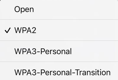

Hello, I had a similar issue. I moved and got a new internet router/modem. The internet name and password remained the same, but my printer would not connect to it and never gave me the option to input a password at all.
Based on a comment from “shadowsports” on one of the other community posts I had looked at, I was able to solve it by changing the security mode of my WiFi settings to WPA2. The new router had it at WPA3, and I think the printer isn’t compatible with that mode. After changing to WPA2, I tried to connect the printer and it asked me to enter a password, and after doing that, it worked. My printer is the MB2120.
