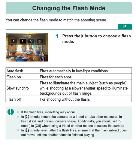

You use the buttons on the back:

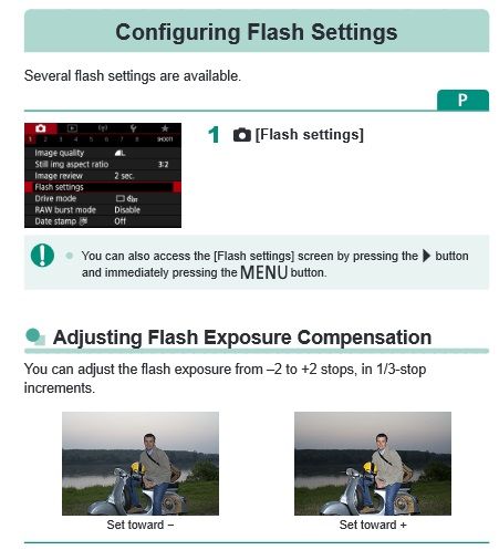

You can also change the settings:
There are some more settings, this is just for an example

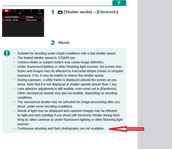

I have a new update on this, I was able to unlock it! The thing is that flash won't work in M mode only where you are using electronic shutter. Change it to mechanic and it should work just fine. Try it and let me now.
As usual, it is in the manual:
