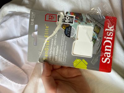

My canon power shot sx240 hs is not working right. It has a memory card in *attached* however it says memory card error and doesn’t work *also attached* any help would be appreciated

First thing is, DON'T use Micro SD cards. They are not usable in many cameras. You don't show an adapter. Presumably you put the micro card in one to put it in the camera, right? Only use full-size SD cards.
After you get an SD card, no larger than 16 GB, (not Micro) put it in, format in the camera, and see what happens.

To add to normadel's advice above . . .
Your problem will very likely disappear if you instead use a FULL SIZE SDHC memory card. Try to keep it 32gb or smaller. Do you have a full size SD card you can experiment with? If so, be sure to copy any irreplaceable data that may be on it to your desktop or laptop. After putting it in your camera be sure to do a low-level format of the card in the camera. THIS WILL ERASE ANY DATA ON THE CARD if it was a used card. An unused brand new card should also be formatted in the camera as well.
If you end up buying a new card, try to buy one from a camera shop or trusted local electronics store. It can be risky buying from many Amazon or Ebay vendors. There's too many dealers selling cheap third party or counterfeit brand name cards. As discovered by forum member Ray-uk . . .
https://community.usa.canon.com/t5/General-Discussion/SD-Card-surprise/m-p/298627
Your sx240hs (as compared to a higher end DSLR or MILC camera) may not be too fussy about having an expensive brand-name card, but who knows. Though you should definitely avoid using a micro SD card with an adapter in it. Having an extra set of very tiny electrical contacts added to the circuitry between the camera and the memory card is just adding another potential failure point.

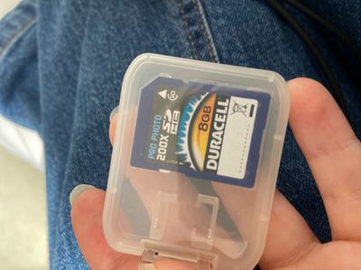

05-26-2024 10:29 AM
Hi I tried with a full sized SD card *attached* but it is still saying memory card error. I formatted the card and still says the same thing. Would it be best to try a brand new SD card or would this make no difference? Thanks

05-26-2024 11:07 AM - edited 05-26-2024 11:09 AM
@Annawills700 wrote:Hi I tried with a full sized SD card *attached* but it is still saying memory card error. I formatted the card and still says the same thing. Would it be best to try a brand new SD card or would this make no difference? Thanks
I suggest that you purchase a new, major brand name, memory card. Judging from the packaging and markings, that card is possibly another micro-SD card. There is room inside the case to hold one. And, that card is probably over ten years old.
