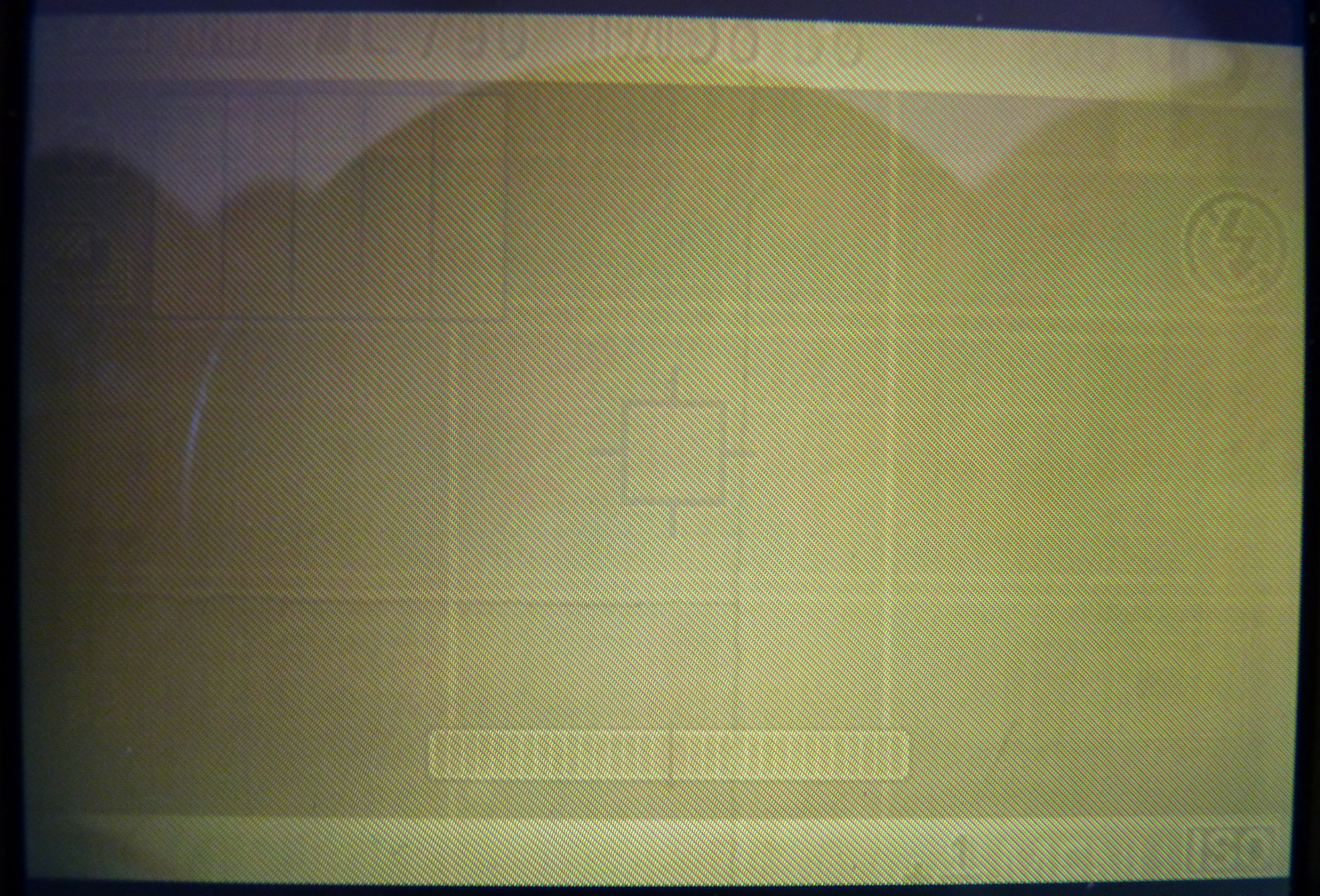

There is a faint image on my screen of things like the battery level and flash indicator. Not in viewfinder not are files affected.

The screen goes black when the evf is in use. This is a snap of a ceiling and appears like this on the screen. The actual file is plain on a pc viewer. Tried reverting to factory settings.

I think your going to need to send it in for repairs, at least speak to Canon about it. If you can return and replace it ?
It looks like there is some internal leakage in the LCD panel causing some of the segments to faintly light up.
