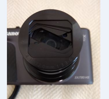

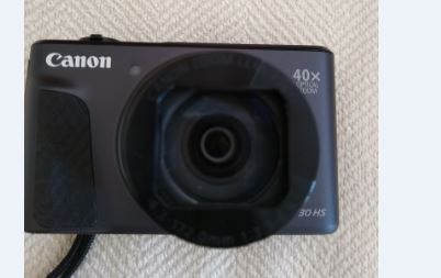

When the camera is turned on, the metal 'leaves" that cover the lens should fully open. They do not. See the attached pictures. Picture #1 shows what the lens looks like fully open. Picture #2 shows the lens partially open with the metal leaves stuck in a half open position. In this half open position I can fully open the lens cover by lightly nudging the metal leaves. Note that when I turn the camera off, the metal leaves do not fully close and again I need to gently nudge the leaves to get them to close.
So how do I fix this? Perhaps there is dirt between the metal leaves, but I am having trouble getting between the leaves to remove potential dirt.

This lens cover is a very delicate mechanism and as such it doesn't take much to stop it working, it is quite possible that you have somehow bent the mechanism or got a grain of sand inside it. either way there isn't much you can do with it without disassembling it and that is not a course of action that I would advise. You could try giving it a blast with canned air that might clear any obstruction.

Simple solution. But be carefull and do this per side, even the small corners, and test it first. It listens very narrow, so don’t do all the sides (6 including the little corners) at ones. I had a phone repair kit that included the tools needed. I opened the metal leaves and started lifting the side a little bit up, then tested the open/close. I started with one side only, including the small corners, one by one. When that didn’t work, i tried the other side. And suddenly it started working. The metal leaves open and close every time now. I have the Canon HS730SX
