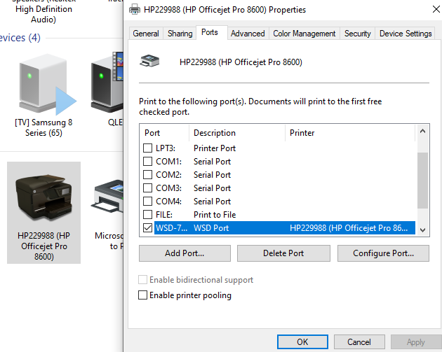

Greetings,
Very first step. Ensure you don't have any unprinted documents stuck in your print queue. If clear, lets see how the printer is communicating with the computer. (You should only have one instace of the printer present)
The printer should be connected directly to a USB port and not through a hub (example)
Now open:
Control Panel > Device and Printers > Right-click on the printer icon and select Printer Properties from the context menu.
Now select the ports tab and review for a port with the prefix "USB..." you may see one or more entries with the name of your printer present. One should have a check mark.
If so, try unplugging the printer and moving the USB connection to another USB port. Ensure there are no unprinted documents in the print queue and try printing again. If this fails, remove the most recent failed document from the queue.
If there is another USB entry in "Ports", with the printer's name, select it and apply. Retest printing
Below is an example photo of what printer properties looks like.
If these steps do not help, we will need more information about your environment. What type of antivirus you have installed, etc

12-03-2019 01:27 AM
for reasons I still don't know, the printer did not install as a usb printer. it was on lpt1.
i kept deleting printers from devices and printers until there were no more, rebooted the computer, and the printer immediately installed itself on a usb port as it should have.
test page worked and I assume it is fine now.
