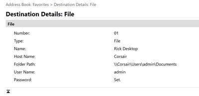

The error you describe is displaying because the the scan to destination does not exist or does not have valid write permission set on the folder or destination. Add the path to the destination and the address book. Then create a folder in the directory or path specified and ensure it has proper permissions.
Here is an example from my address book

I verified that the destination folder has write permissions. I could not figure out how to make the address book changes that you suggested.

Lol as soon as I sent my last reply, I checked the address book again and realized that I had just been logged in as a user and not system manager. Once I did that, I was able to add the path to the address book.
Will post again after a few days with results.
