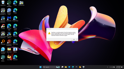

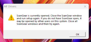

Now I can't install drivers. I keep getting this about Scan Gear. It was uninstalled.
07-27-2025 12:52 PM
Maybe that would explain the offline. Using the ip of the printer is the only it would install.
07-27-2025 02:31 PM
Hi,
Your image is low resolution, I'm not able to enlarge or read it. Please post a larger image of the error or provide the text.
You are using USB for the connection type. You said there is no network. You aren't connecting the printer to Ethernet or Wireless, therefore there is no network IP address. The printer would need to be connected to a network for it to get an IP. So yes, you would not be able to specify or connect to a fictitious address that does not exist.

Don't you get a little plus sign when you put your curser on the pict.?
07-27-2025 04:30 PM
USB is the only way I can go if I can figure how to do that. The only thing Canon instructions tell you to do is plug in the cable. That does not work. Now if I can't install drivers, it's useless. I have removed every trace of that ScanGear I could find.
